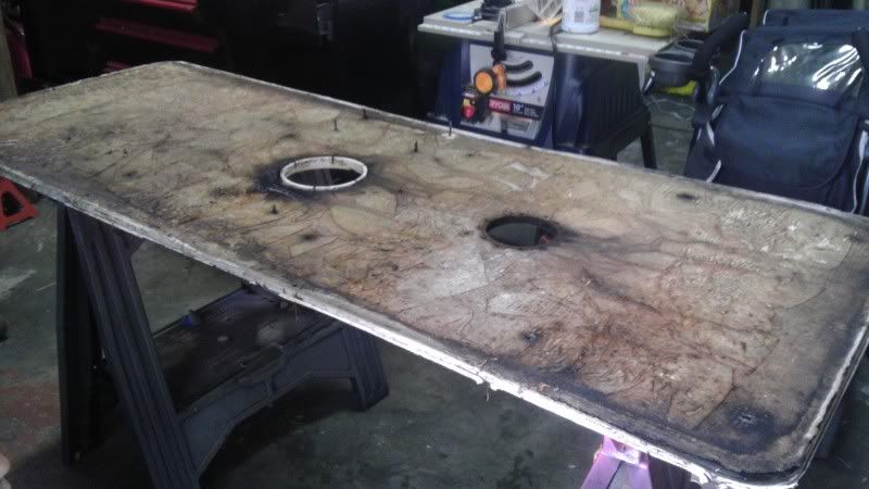

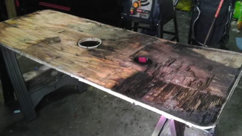

Starting to get along on the boat.. one of the biggest things i need to do is fisx the coffin cover.. its heavy, water logged and soft.. i knew this buying the boat but figured it was because it was a panel.. the rest of the floor is solid.. so heres where im at.. got a couple hrs work in.. all i got left is to sand and recore.. im gonna let it dry out a little before i start sanding..
this is what i started with
got the bottom layer of glass off
cleaned down to the glass for the most part..

Been there done that! There is thread on CAS from a few years ago where I redid mine. Looked just like yours when I peeled off the bottom skin and core.
Edit: Here it is! http://www.classicaquasport.com/phpbb3/viewtopic.php?f=2&t=4360&hilit=coffin+cover+rebuild

well.... the wood lasted for a while so it will get wood.. im going to use 3 strips length wise with a little gap in between.. going to sand everything down and mix up some thickened resin.. then sandwich the wood and top of lid with some thickened resin..(i grabbed some cabsoil today) .. then before i glass the bottom im going to fill in the gaps with some pb and a light layer over the wood.. then some glass to finish it up..
the boat is 25 years old.. as you can tell from the pics most of the water entered from where the cooler seat was bolted down. then a little around the access covers and very little from the batt tray.. nothing had any kind of sealant on it, the screws for the batt tray had loctite.. sSc_eek

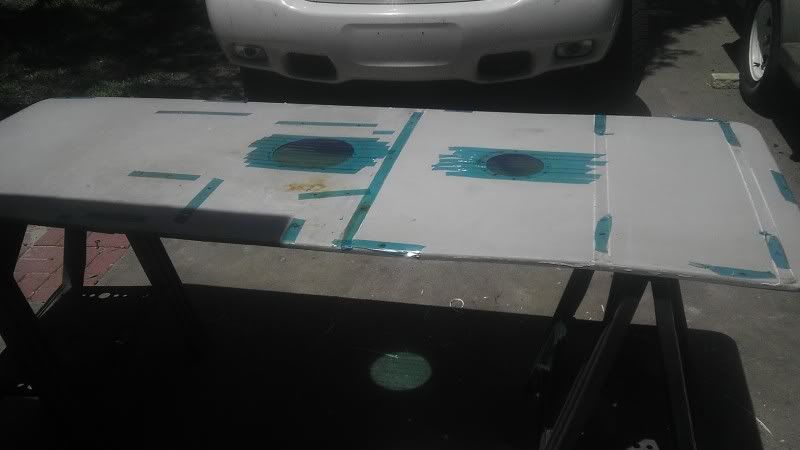

Post Posted: Wed Apr 18, 2012 5:30 pm
got a little more work done.. changed up the original plan and just used one whole piece of wood
all sanded down
some "blue" tape.. this stuff is amazing, it sticks to everything but resin doesnt stick to it
now for some weight, both cans are 1/2 full of water..
so what i ended up doing was mixing up some resin and putting it on the wood.. did a nice thick coat.. then i mixed up a nice thick pb with some cabsoil and put it on the skin.. put the 2 together and applied weight.. i mixed the pb a little on the cold side, ill let that setup overnight and most of the day tomorrow.. then to finish it
Current boat

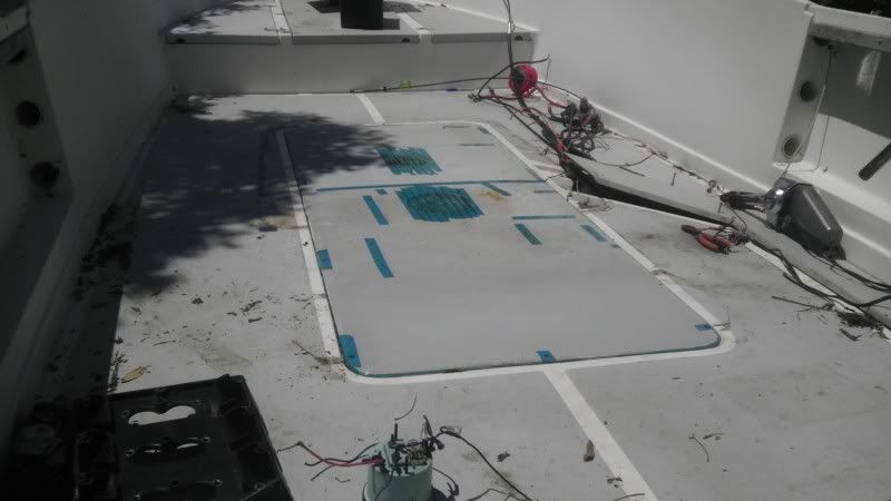

Post Posted: Thu Apr 19, 2012 5:19 pm
well here it is test fitted.. last time it will look like this.. stage 1 is complete
now to cut a big ass hole in the front of it.. stay tuned, within the next couple of days it will be done

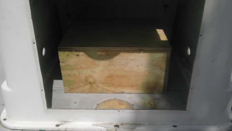

Post Posted: Sat Apr 21, 2012 3:11 pm
heres a little better idea of what im doing..
